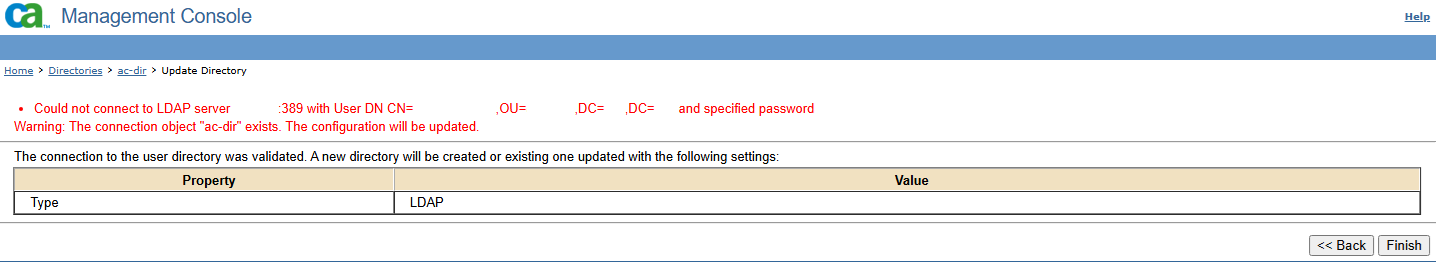

When trying to update the AD bind account for Enterprise Management in idmmanage, the following error occurs.
  • Could not connect to LDAP server adserver.example.com:389 with User DN CN=ExampleBindUser,OU=Users,DC=example,DC=com and specified password
