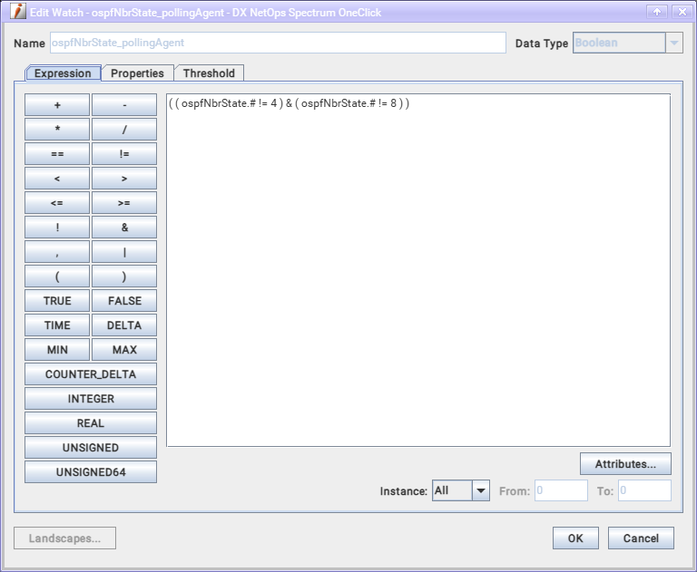

This is the spoken expression: Generate alarm only when the ospfNbrState value is different from 4 and 8.
This is real expression: ((ospfNbrState.#!=4)&(ospfNbrState.#!=8))
Note that the expression is evaluating the same instance (#).
Suppose the ospfNbrState value is 1: TRUE & TRUE = TRUE (generate alarm)
Suppose the ospfNbrState value is 2: TRUE & TRUE = TRUE (generate alarm)
Suppose the ospfNbrState value is 3: TRUE & TRUE = TRUE (generate alarm)
Suppose the ospfNbrState value is 4: FALSE & TRUE = FALSE (clear alarm)
Suppose the ospfNbrState value is 5: TRUE & TRUE = TRUE (generate alarm)
Suppose the ospfNbrState value is 6: TRUE & TRUE = TRUE (generate alarm)
Suppose the ospfNbrState value is 7: TRUE & TRUE = TRUE (generate alarm)
Suppose the ospfNbrState value is 8: TRUE & FALSE = FALSE (clear alarm)
1) In the Expression tab:
  • Name: ospfNbrState_pollingAgent
  • Data Type: Boolean
  • Expression: ((ospfNbrState.#!=4)&(ospfNbrState.#!=8))
  • Instance: All
Only when the ospfNbrState value is different (!=) from 4 and (&8 an alarm should be generated.

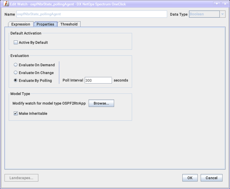

2) In the Properties tab:
  • Active By Default: Unchecked
  • Evaluation: Evaluating By Polling - Polling Interval 300 seconds
  • Model Type: Modify watch for model type OSPF2RtrApp
  • Make Inheritable: Checked
