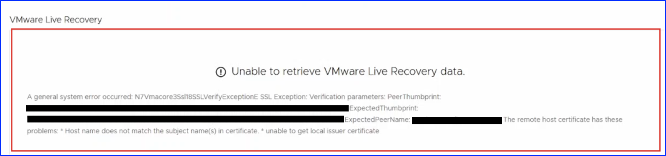

  • The VLSR Reconfigure task fails citing a thumbprint mismatch.
    Reconfigure reports following error:
  • Issue may be also be reported when vCenter FQDN or IP is changed which eventually needs Certificate replacement.

  • The VLSR /opt/vmware/support/logs/srm/vmware-dr.log throws below error:
    YYYY-MM-DDTHH:MM:SS.SSS +08:00 warning vmware-dr[01374] [SRM@6876 sub-Default connID=1kp-####] StubExcTranslator : Error while calling stub for 'lookup.ServiceInstance:ServiceInstance'
    --> N7Vmacore3Ssl18SSLVerifyExceptionE SSL Exception: Verification parameters:
    --> PeerThumbprint: #:#:#:#:#:#:#:#:#:#:#:#: #:#:#:#:#:#:#:#:#:#:#:#: #:#:#:#:#:#:#:#:#:#:#:#:#
    --> ExpectedThumbprint #:#:#:#:#:#:#:#:#:#:#:#: #:#:#:#:#:#:#:#:#:#:#:#: #:#:#:#:#:#:#:#:#:#:#:#:#
    --> ExpectedPeerName: {vcenter fqdn}
    Where:
    PeerThumbprint --> Is the new vCenter Thumbprint
    ExpectedThumbprint --> Is the previous vCenter Thumbprint
