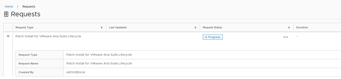

  • You are attempting to install new patch for Aria Suite Lifecycle.
  • Patch install task for Aria Suite Lifecycle 8.18 Patch appears stuck with a Request Status of In Progress.
  • The appliance has fully rebooted and reporting the latest version you just applied in the System Details page.
VMware Aria Suite Lifecycle 8.18
This is an intermittent issue potentially caused by a race condition between script execution and the halting of Java services.
If the patching task appears stuck in the UI, you can validate that it has completed successfully in the backend and then safely cancel the UI task.
  1. Check the patch log file at /var/log/vrlcm/patchcli.log and look for the following completion messages near the end of the file:
    Restarting server
    <Time Stamp> 17:57:27,574 - __main__ - INFO - patch installation process ended.
    <Time Stamp> 17:57:27,579 - __main__ - INFO - patch installation completed.
  2. If these messages are present, the patch installation was successful. You can now navigate to the Requests page in the UI and cancel the stuck task.
