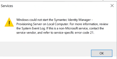

Seeing the following error while attempting to start provisioning server from Windows service with error code 21
In the IMPS log, we see the following:
TLS: can't connect.
backend_startup: bi_db_open 0 failed!
slapd stopped.
connections_destroy: nothing to destroy
Identity Manager 14.5 Standalone
DSA certs issues
Copy the following cert files from the working CA directory config and config\ssld\personalities folders to the non-working CA Directory node onto the same folders.
impd_trusted.pem
master.p12
hostname-impd-co.pem
hostname-impd-inc.pem
hostname-impd-main.pem
hostname-impd-notify.pem
After the certs are copied, please restart the DSAs.
