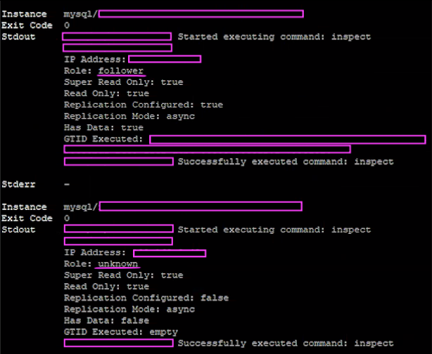

The MySQL service instance is a Leader-Follower HA cluster. However, the inspect errand of the corresponding BOSH deployment of the MySQL service instance shows that the mysql cluster is not in good leader-follower state. As shown in image below, one mysql instance is follower while the other is in "unknown" state.
Try to run make-leader errand to make the mysql instance in "unknown" state the leader role. The BOSH CLI command would be like,
$ bosh -d service-instance_7626f775-##-##-##-df90951c3855 run-errand make-leader --instance=mysql/d02cb916-##-##-##-a5879aa5ec12
After the errand completes successfully, the mysql cluster would be in leader-follower state. Run inspect errand to confirm.
$ bosh -d service-instance_7626f775-##-##-##-df90951c3855 run-errand inspect
Then attempt to unbind the MySQL service instance again, which should be successful.
