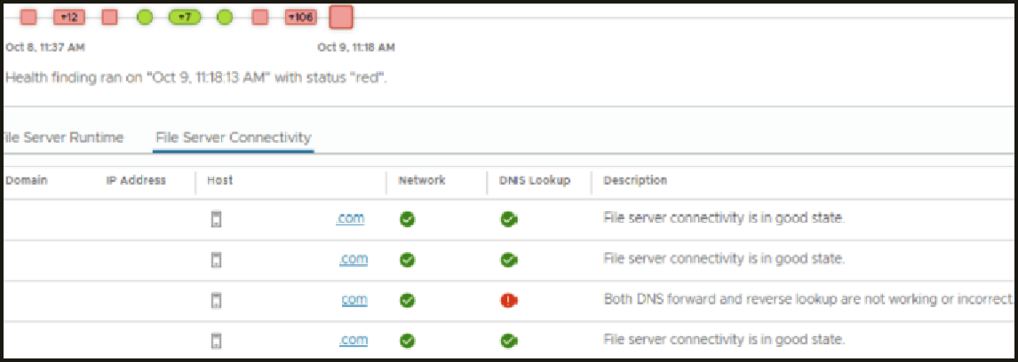

Symptoms:
  • In vSAN Skyline Health, the File Server Health will appear in red with below errors:
vCenter UI>vSAN Cluster>Monitor>Skyline health
