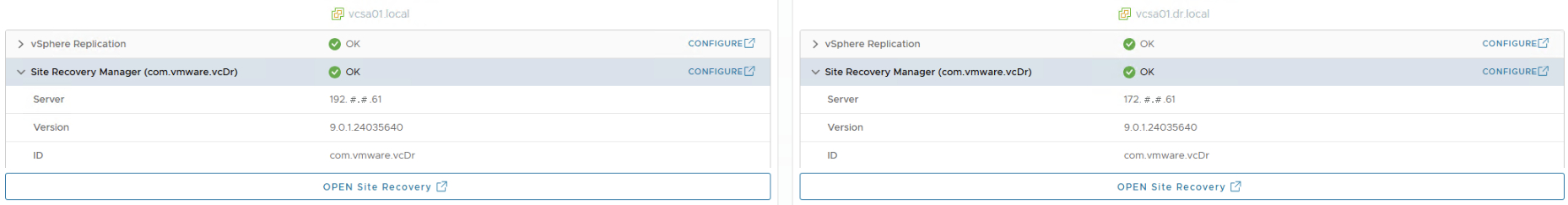

This KB article explains how to add a Site Recovery Manager (SRM) site pair with a custom extension to an existing vCenter Server deployment already utilizing an SRM site pair with the default .vcDr extension.
For example:
 VC A  ---------  VC B    --> vCenter
SRM A1 --------- SRM B1   --> Existing pair with .vcDr extension
SRM A2 --------- SRM B2   --> Custom extension site pair

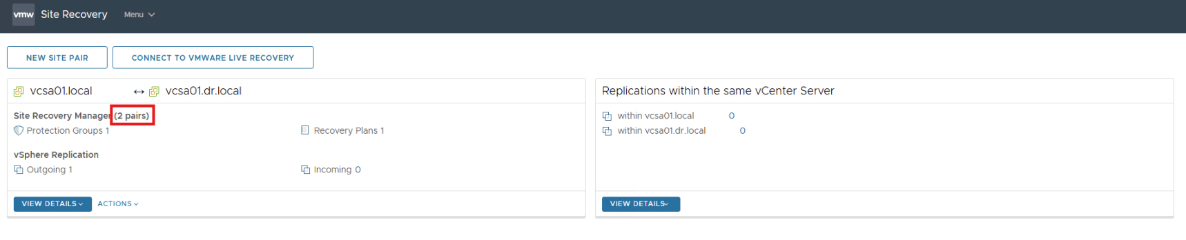

Follow below steps to configure additional SRM site pairs -
  • Click on "Actions" > select "Add Pairs" > select the newly deployed SRM pairs.
  •  Click on "View Details" > Now we will see both the site pairs under the same vCenter.
