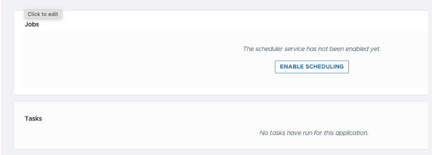

CF Tasks are not visible in Apps Manager UI however the tasks runs without problem.
  • When listing cf tasks it throws "UnknownError","detail":"An unknown error occurred.","code":10001

  • Apps Manager Ui shows no tasks for application.
