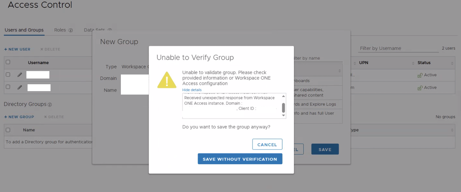

When attempting to configure the Workspace ONE Access (vIDM) integration or when trying to add new Active Directory (AD) users within the Aria Operations for Logs UI, the operations fail.
  • The Workspace ONE Access Test Connection may show Succeeded, but the overall integration Status may display DISCONNECTED.
  • In the UI, when attempting to add new Active Directory users, the following error is displayed:
    ResourceException: Unexpected HTTP response from Workspace ONE Access instance. :: null Received unexpected response from Workspace ONE Access instance. Domain : <vidm-hostname>, Client ID : <client-id>.
