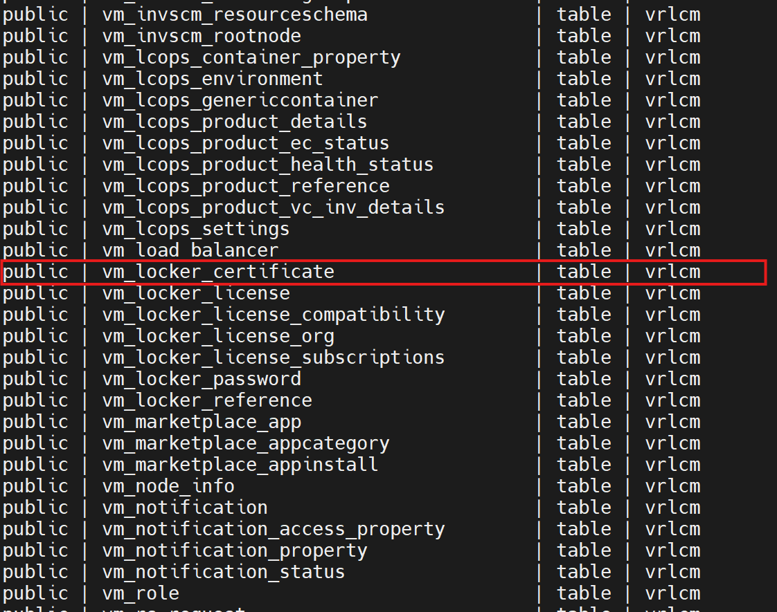

3. Run the below command to list all the database tables.
\dt
4. Locate the "vm_locker_certificate" from the list of database tables.
