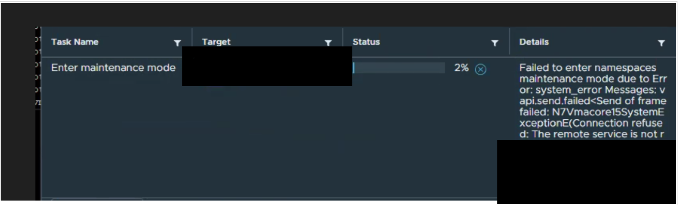

  • ESXi host stalls at 2% while attempting to enter maintenance mode  with the below error :
    Failed to enter namespaces maintenance mode due to Error: system_error Messages: vapi.send.failed<Send of frame failed: N7Vmacore15SystemExceptionE(Connection refused: The remote service is not running, OR is overloaded, OR a firewall is rejecting connections.)
