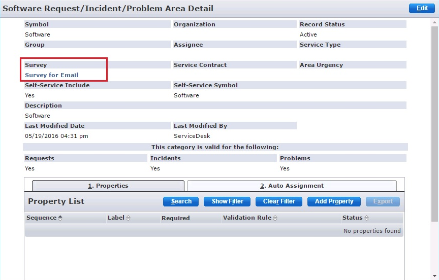

In an environment where Surveys are configured for Ticket Type (see Additional Information section for reference on it), if you need to have Surveys sent by specific Request Areas or Categories, you should simply add the Survey Template to the Request Area or Category definition:
How is this going to work?
So you have SDM Surveys configured and now how will it recognize which survey to use?
SDM will check for any Survey configuration in the Request Area/Category of a ticket.
If one exists, then it will be used.
If none exists, the it will use the default one set for the ticket type.
