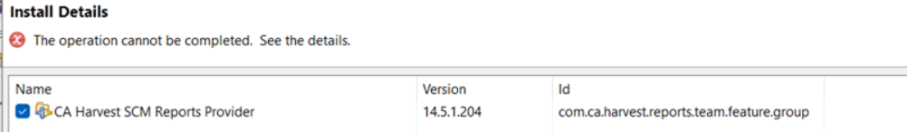

The second time installing the Report Provider I got the following error message.

It looks like you have missed installing BIRT dependencies which is a pre-requisite for this.
Follow the link found in the documentation to download the BIRT 4.15.0 dependencies update.  Then redo the installation.
  1. Delete the Eclipse 4.36 and unzip a fresh copy of 4.31.  Be sure to also delete the C:\Users\<userid>\Eclipse-workspace folder.
  2. Install CAHarvestSCMV145_01Patch_SCMECLIPSEPLUGIN_14.5.1.204.
  3. Install BIRT-Updates-4.15.0.zip
  4. Install CAHarvestSCMV145_01Patch_SCMREPORTSECLIPSEPLUGIN_14.5.1.204.zip
Details on installing the BIRT Reporting plugin can be found here: Install CA Harvest BIRT Reports

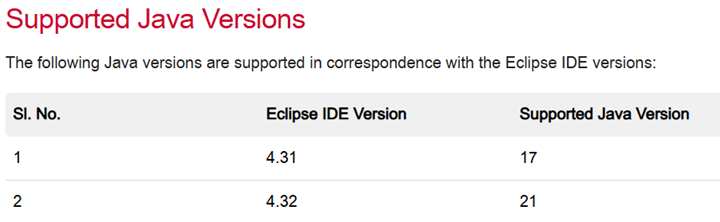

Also note that the version of Eclipse and of AdoptOpenJDK are closely associtated as follows:
