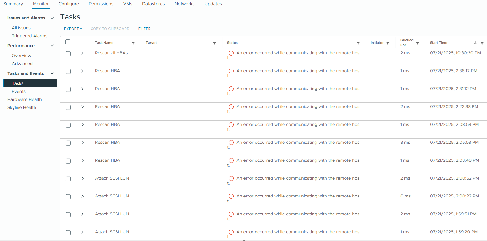

Storage rescans triggered by 3rd party back-up application are timing out causing the back-ups to fail
All ESXi versions
Faulty HBA causing Rescans to fail to complete:
2025-07-21T09:06:42.954Z Wa(180) vmkwarning: cpu52:128829230)WARNING: ScsiScan: 3180: Waiting for scan to finish on vmhba3
2025-07-21T09:06:43.959Z Wa(180) vmkwarning: cpu48:132152539)WARNING: ScsiScan: 3180: Waiting for scan to finish on vmhba3
2025-07-21T09:07:42.957Z Wa(180) vmkwarning: cpu48:128829230)WARNING: ScsiScan: 3180: Waiting for scan to finish on vmhba3
Preform a reboot of the ESXI host to clear the storage network connection to the HBA.
If the issue persists after reboot open a case with VMware support, and gather and upload the host logs for further investigation.
