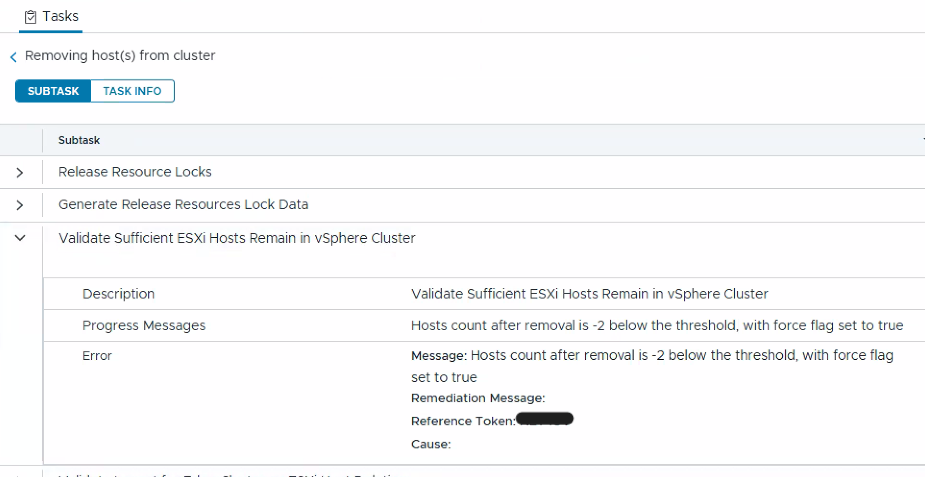

  • Host removal task or decommission task might also fail with the error :
    Description : "Validate Sufficient ESXi Hosts Remain in vSphere Cluster".
    Progress Message : "Hosts count after removal is -2 below the threshold, with force flag set to true"
