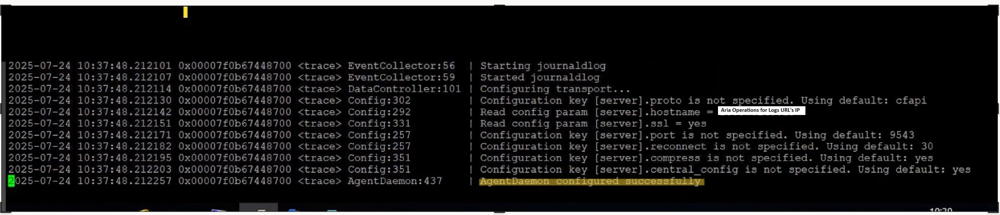

  • Post above steps liagent logs reports successful connection as below:
