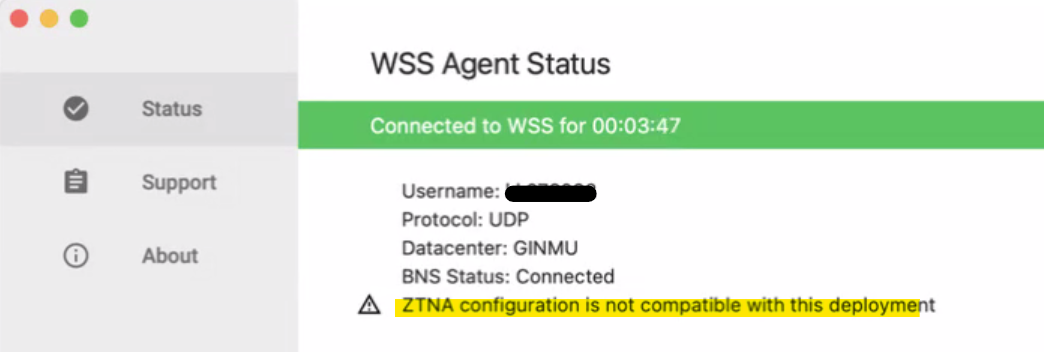

Some users with ZTNA enabled report problems accessing segment applications- connectivity errors at the application layer.
Some of the impacted users see "ZTNA configuration is not compatible with this deployment" messages on the WSS Agent UI status page as shown below:
Other impacted users do no see this message.

Impacted users were authenticating with Auth Connector integration.
Make sure that the all ZTNA enabled users are authenticating with SAML.
  • Users reporting issue NOT using SAML but local auth with Auth Connector to retrieve groups
  • We reference 3 groups in the Cloud SWG ATM config (Okta, AD and hybrid Okta/AD)
  • Users with 9.8.3 correctly see the message that ZTNA is not compatible - this is because ZTNA needs SAML auth
  • 9.7.1 users see ZTNA is enabled, but when accessing a segment based application it fails (again normal as we have no name identifier to pass into ZTNA). WSS Agent 9.7.1 is not going to be fixed.
