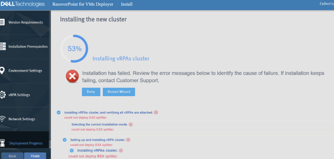

  • From Dell's RecoverPoint for VMs Deployer, the following errors would be observed for the ESX splitter:
    "could not deploy ESX splitter"

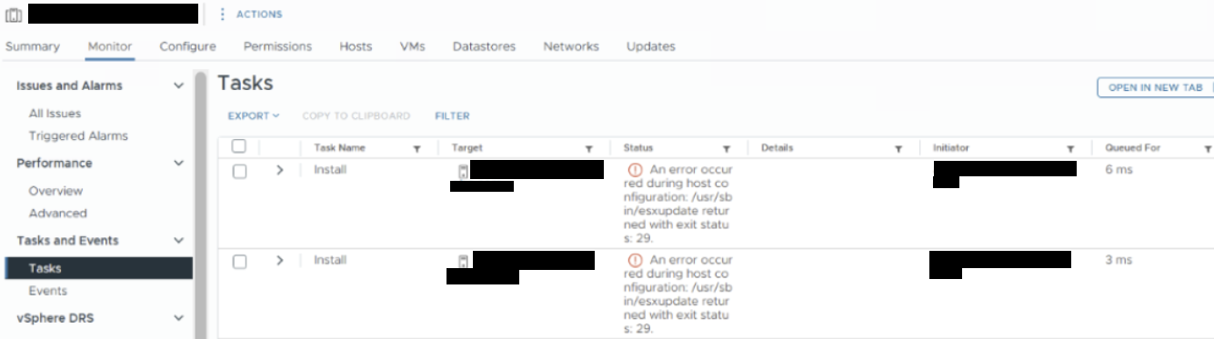

  • On the vSphere Client, the following error can be seen for the Recover Point VIB installation tasks:
    "An error occurred during host configuration: /usr/sbin/esxupdate returned with exit status: 29."

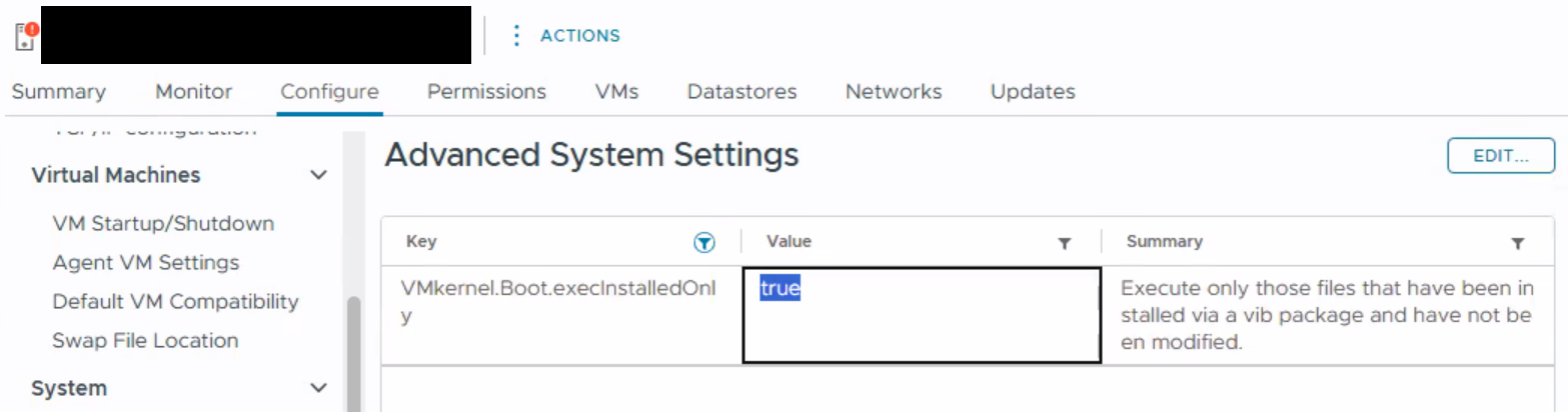

Note: Sometimes the value is set to false by checking it from the CLI steps above. However from vSphere UI, the value is set to true from below field, the value must be modified from UI as well followed by ESXi reboot
  1. In the vCenter GUI, change the VMKernel.Boot.execInstalledOnly setting to false
    1. Navigate to the host object -> Configure Tab -> Advanced Settings
    2. Click the Edit button in the upper right
    3. Update the VMKernel.Boot.execInstalledOnly value to 'false'
    The TPM no longer enforces the execInstalledOnly boot option.
  1. Reboot the ESXi host.
Run the Recover Point VIB installation again.
