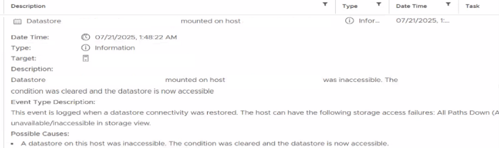

  • On vCenter VM under Monitor>Events you may observe below events:
  • NFS datastore were vCenter VM is residing may report intermittent disconnections leading to datastore inaccessible state. This can be seen under NFS datastore>Monitor>Events
  • In /var/run/log/vmkernel.log you may see NFS datastore has undergone as APD (All path down) state with NFS server disconnections.
