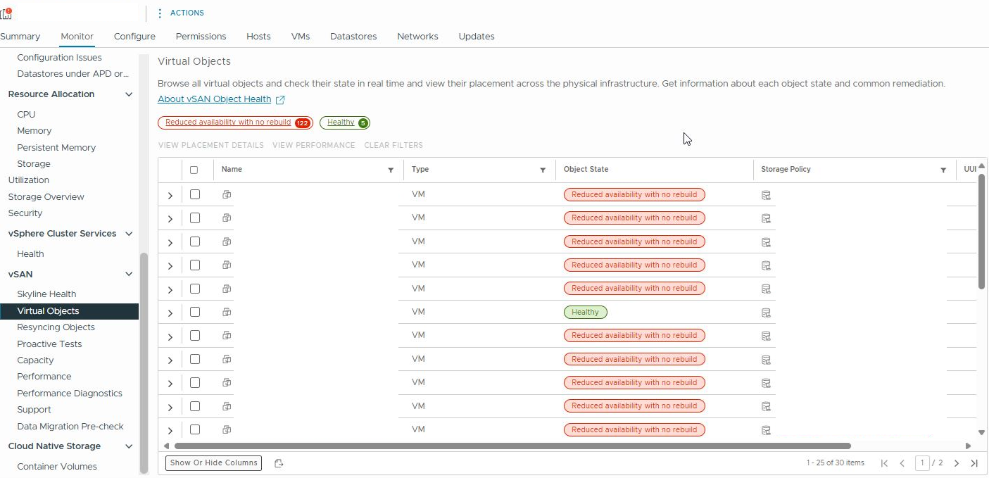

  • A 2-node ROBO cluster experienced vSAN objects in a "Reduced availability with no rebuild" state after the witness appliance was replaced.
  • Even with a stretched storage policy, all data objects are in a "reduced availability with no rebuild" health state.
