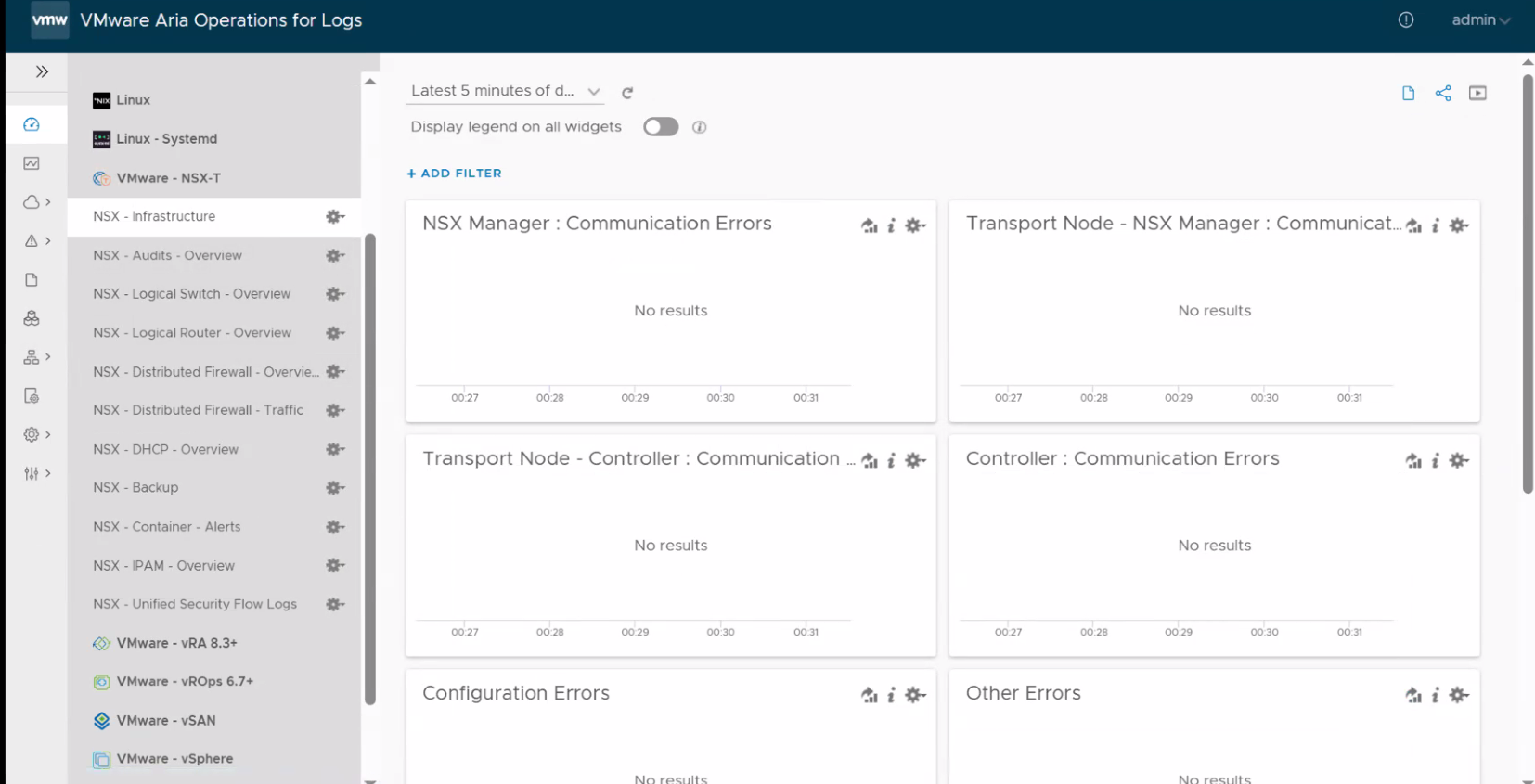

You have successfully installed latest NSX Content pack v4.1 or v4.2 in Aria Operation for Logs 8.18.x, then configured on all our NSX Managers remote syslog to it.
You see the logs coming both from NSX Managers and Edge nodes in Explorer view of Aria Operation for Logs .However, the dashboard provided by the NSX plugin are blank
Aria Operations for logs 8.18.x
The dashboard displayed zero values because there were no specific events occurring within the selected 5-minute window.
For these dashboard to work, it is required that the NSX Content pack is configured after installing, Please follow the NSX setup instructions on the Content pack

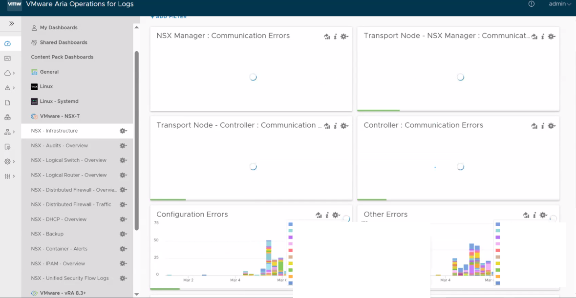

Post configuration, please expand the time interval in the Aria Operations for Logs UI > Navigate to Dashboards >Select the required dashboard > Increase the time range to a larger interval (for example, 1 hour, 24 hours, or more) to verify that the data is being populated in the dashboards.
