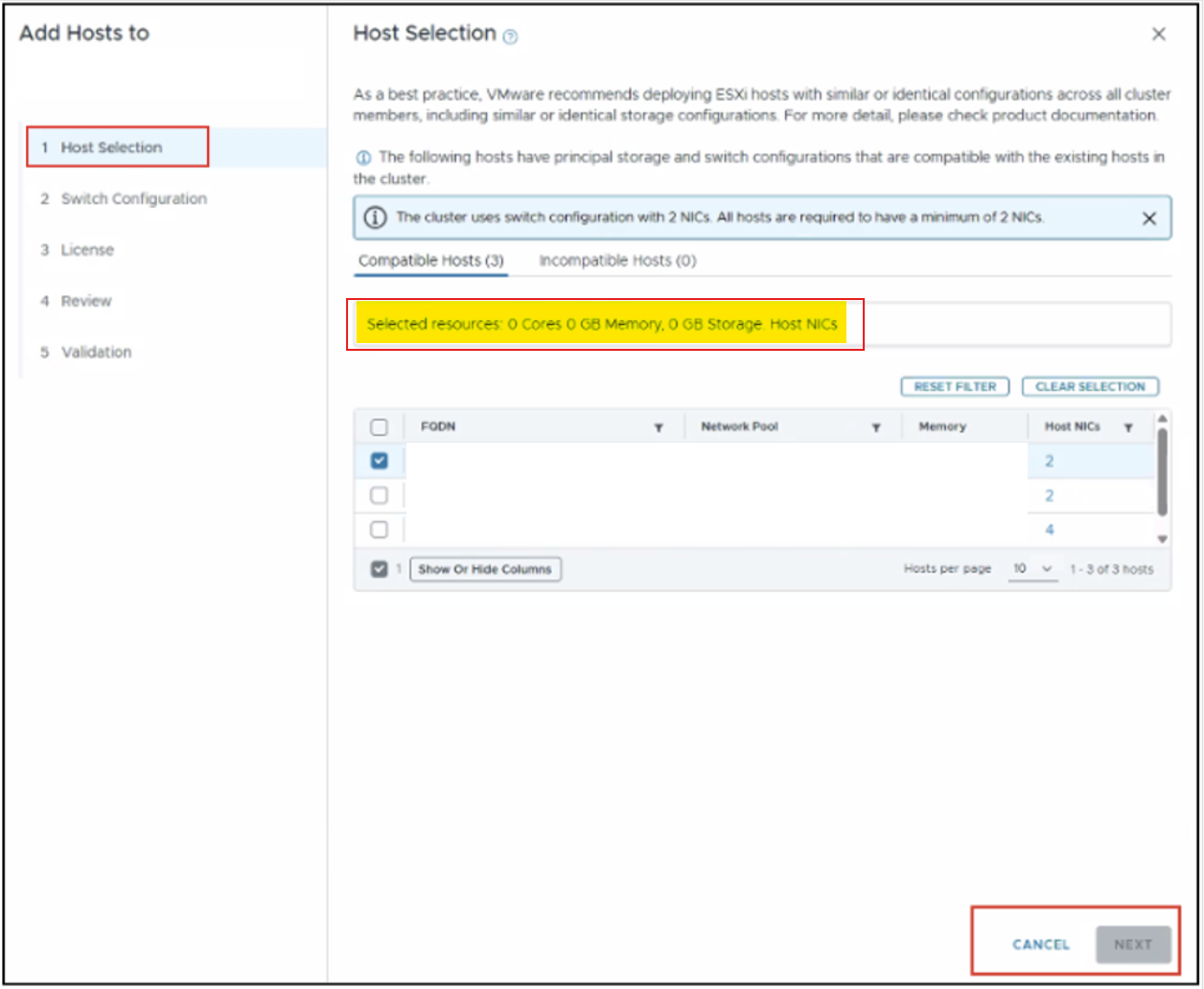

  • Adding a Host adding a host into an existing workload/Management domain fails with the below error
    Error in SDDC Manager UI
    Error description: Cluster is marked as imported. This operation is not allowed on imported clusters
    Remediation: This operation should be performed through vCenter for
    clusters imported in SDDC Manager

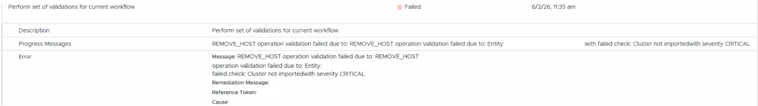

         ADD_HOST operation validation failed due to: ADD_HOST operation validation failed due to: Entity: NAME-###-#### with failed check: Cluster not importedwith severity CRITICAL
