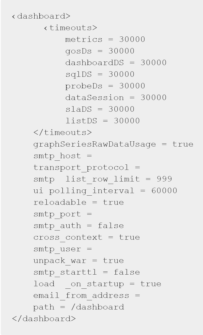

The wasp.cfg dashboard section contains the raw parameters for setup of the SMTP configuration:
smtp_auth, smtp_user, smtp_starttls, are normally not configured for most customers but must be configured when required.
smtp_host, smtp_port, and email_from_address are required.
