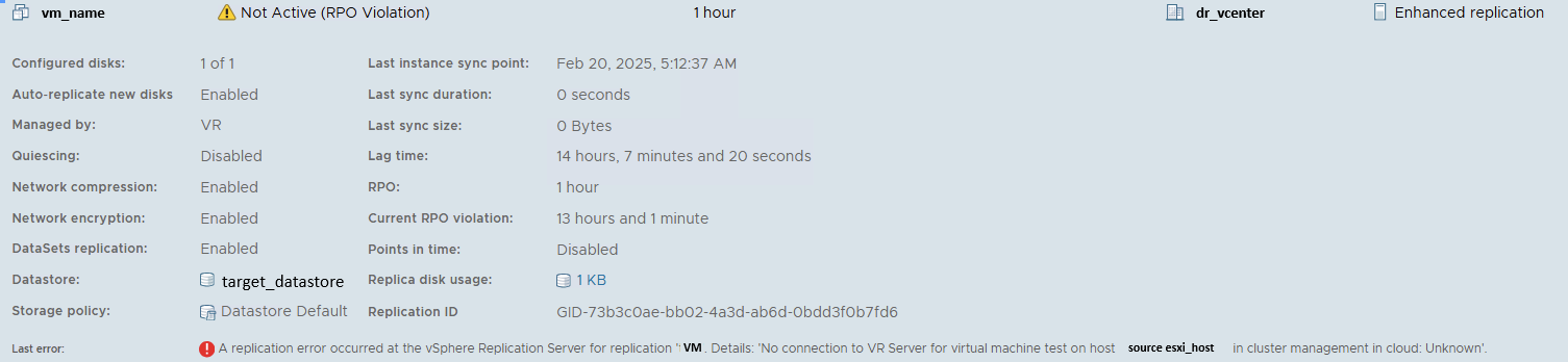

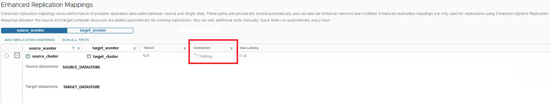

Symptoms:
  • When attempting to add a replication mapping, the Test process keeps running and does not complete.
  • Unable to configure enhanced replication for virtual machines and it fails with the error:
    A replication error occurred at the vSphere Replication Server for replication 'vm_name'. Details: 'No connection to VR Server for virtual machine test on host source-esxihost in cluster management in cloud: Unknown
  • The VLR UI displays below error,
    Unable to connect to HBR Management Server at https://###########:443/vrms. Reason: https://###########:443/vrms invocation failed with "java.net.SocketTimeoutException: 30,000 milliseconds timeout on connection http-outgoing-16071 [ACTIVE]" 30,000 milliseconds timeout on connection http-outgoing-16071 [ACTIVE]

1. Verify mappings under Enhanced Replication Mappings
2.
If you are seeing deadlocks on the VRMS, reboot all the VRMS appliances including VR add-on servers.
3.
If you are seeing 'Login denied errors' on the ESXi hosts, refresh the site pairing and authentication tokens by reconnecting site pairs.
4.
If the VMs continue to show RPO violations or the hosts continue to log HTTP 500 errors 10-15 minutes after the VRMS services are restarted, the host agents may be stuck in a retry loop. Restart the hbr-agent & hbrsrv services on the host clusters used for replication.
Commands to restart from CLI -
/etc/init.d/hbr-agent restart
/etc/init.d/hbrsrv restart
