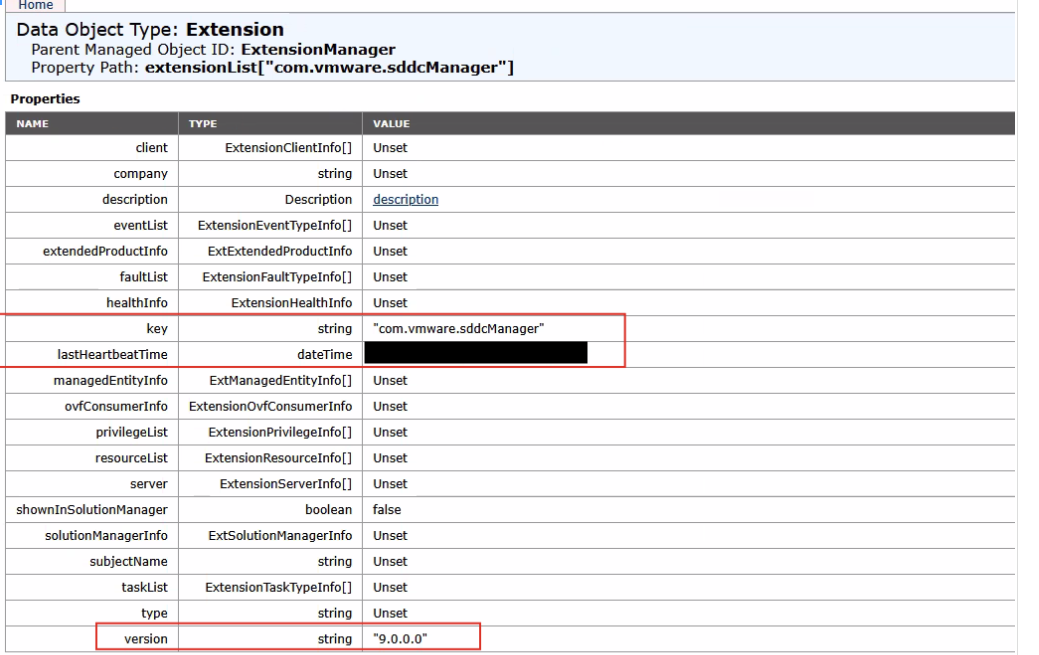

  • Extension list from the vCenter 9.0 when a failed Brownfield import is noticed

  • If you see extension details, it will show the plugin is for version 9.0
