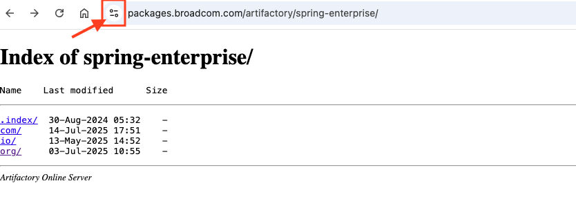

  1. Login with your valid credentials. Guide to login here.

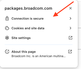

  2. One you are able to access the repository on your browser you need to click on the below icon

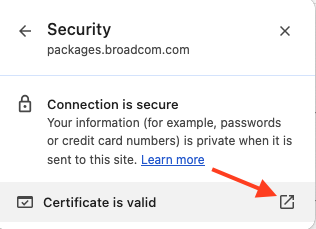

  3. Navigate through the connection is secure option.
  4.  Click on valid certificate

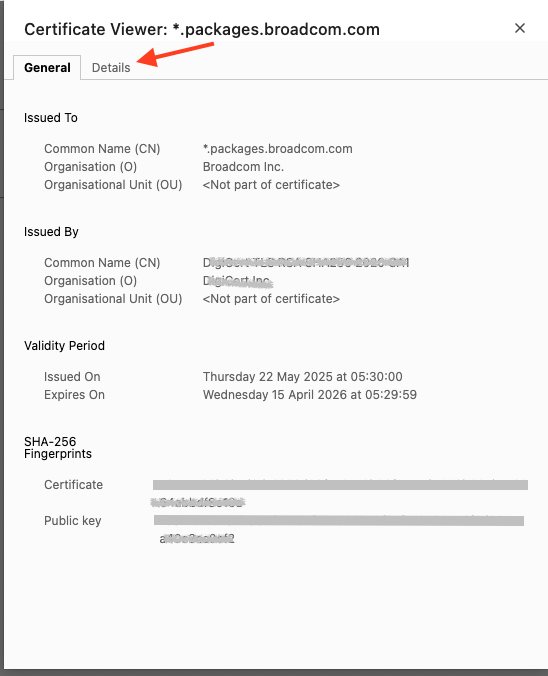

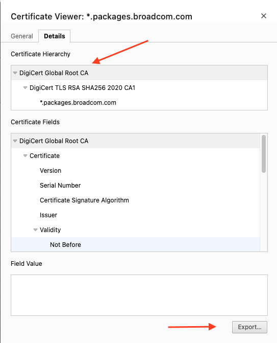

  5. This will open the certificate viewer page on your browser and then click on Details to download the certificate.
  6. Click on the certificate hierarchy to get the Root CA and tehn export and it should get downloaded in the local.
    Once the certificate is download the you can use this in the truststore when configuring the spring enterprise repository in Sonatype nexus.
