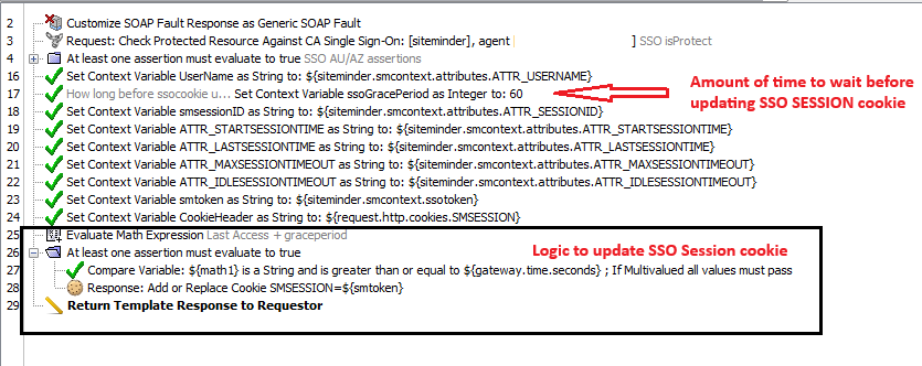

The solution does not need to be that complicated
Simple policy: Tactical Solution “Evaluate Math Expression” is needed
Line 17: Set context variable value (seconds) to delays update of session cookie: ssoGracePeriod  to 60 seconds (set variable to value specific for your environment)
Line 25: Math equation ${ATTR_LASTSESSIONTIME} + ${ssoGracePeriod}  Variable math1
Line 26 Block:  “At least one assertion must evaluate to true”
Line 27: Compare variable from line 25 ${math1} is greater than or equal to ${gateway.time.seconds}  epoch of current Gateway time
This comparison true until the gateway time exceeds the grace period, once false:
Line 28: Cookie is updated
Sample pic of policy:
