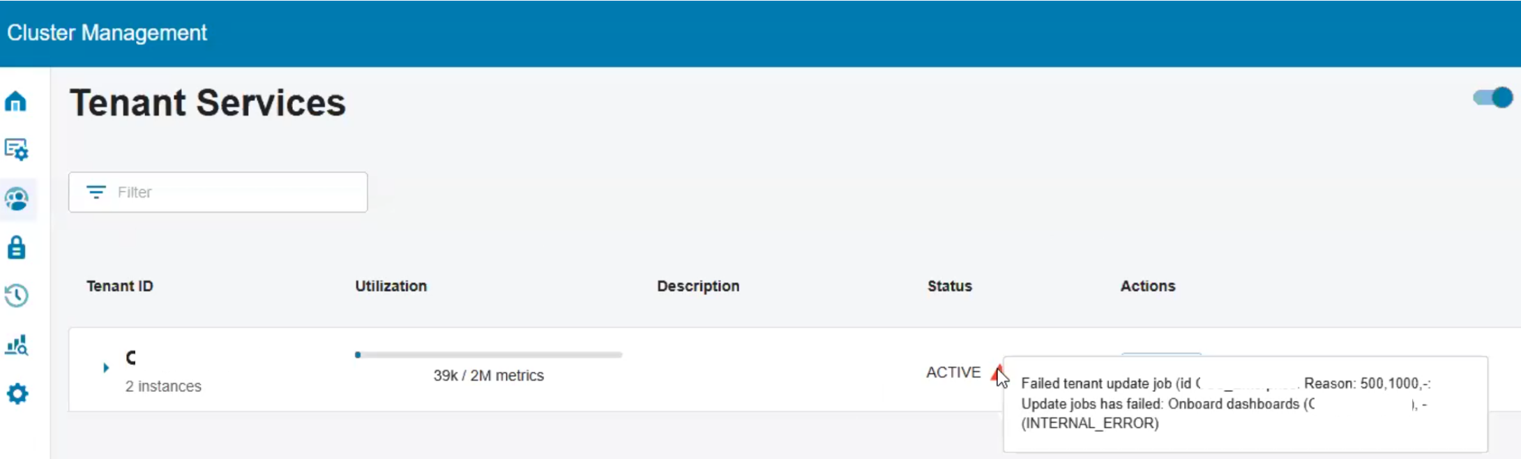

The upgrade completed as expected but in "Cluster Manager" we see the reporting the error:
"Failed tenant update job (id" <your_tenant_name> . Reason: 500,1000,-: Update jobs has failed: Onboard dashboards (<your_tenant_name>), - (INTERNAL_ERROR)"
How to fix the ERROR?
