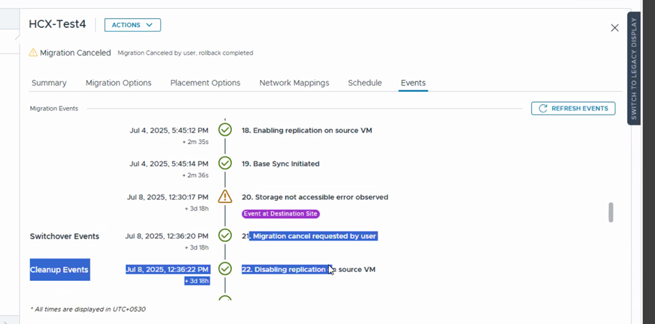

HCX Bulk/RAV migration failed with error, "Storage not accessible error observed".

  • HCX Bulk/RAV Migrations are not progressing beyond 0% with the state Base Sync Initiated.
