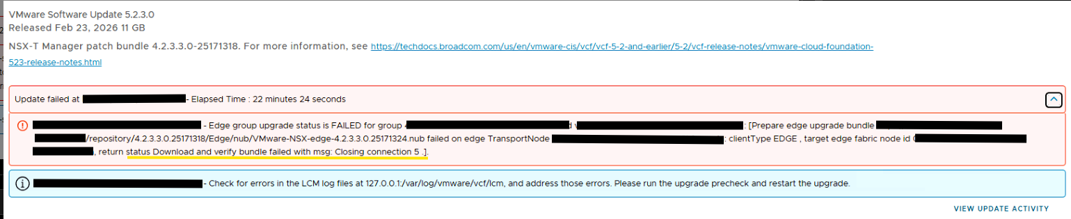

Update failed at <TIME && DATE> - Elapsed Time : 22 minutes 24 seconds
Edge group upgrade status is FAILED for group <UUID> <UUID> :
[Prepare edge upgrade bundle https://<NSX_FQDN>/repository/4.2.3.3.0.25171318/Edge/nub/VMware-NSX-edge-4.2.3.3.0.25171324.nub
failed on edge TransportNode <UUID>: clientType EDGE, target edge fabric node id <UUID>, return status Download and verify bundle failed with msg:
Closing connection 5.].VMware NSX
