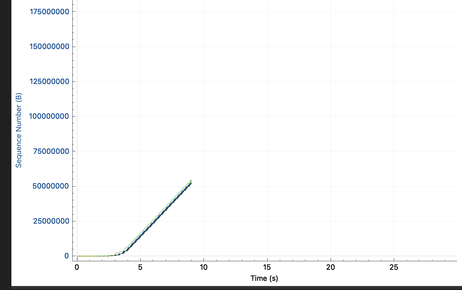

2. Without auto buff enabled, the tcp-stevens graph on wireshark is linear (what you see in 6.7), whereas the 7.3 has a slower start but exponentially grows for large file download via proxysg
a. On 6.7
b. On 7.3
