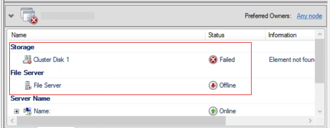

  • The disk on the active node of a Windows Server Failover Cluster (WSFC) unexpectedly goes offline, triggering a cluster failover. While the behavior presents as an offline disk, the underlying issue is that the network adapter of the active WSFC node has gone down.
  • The following error is observed in the Windows Event Log on the active node:
    "Cluster network interface '<VM-name>- Heartbeat' for cluster node '<VM-name>' on network 'Heartbeat' failed. Run the Validate a Configuration wizard to check your network configuration. If the condition persists, check for hardware or software errors related to the network adapter. Also check for failures in any other network components to which the node is connected such as hubs, switches, or bridges."
VMware vSphere ESXi 8.x
An automated or silent upgrade of VMware Tools was executed on the WSFC nodes. This process unloaded the VMXNET3 network driver (upgrading it from version 1.9.19.0 to 1.9.20.0), causing a temporary loss of network connectivity. This interrupted WSFC network heartbeats and prompted the cluster to trigger an immediate node failover to maintain database availability.
