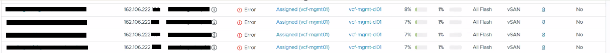

Hosts show "ERROR" status:

Trying to add hosts to a stretched vSAN cluster (management) that spans 2 AZs.  When running the JSON spec file through the API, an expired license key was used.  After correcting the license key on the hosts, the task to add hosts still fails.
Hosts will first need to be manually removed from the database.  Contact Broadcom Technical Support for assistance.
