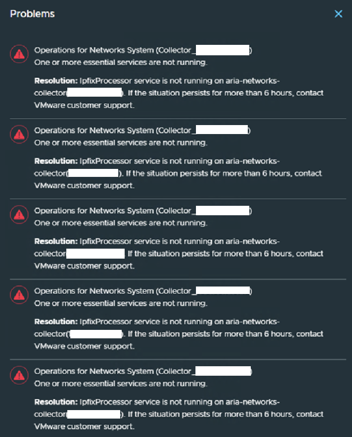

Error message seen on GUI is as below on multiple  Aria Operations or Networks collector(s).
Problem: IpfixProcessor javaservice is not running
Error screenshot as below:
