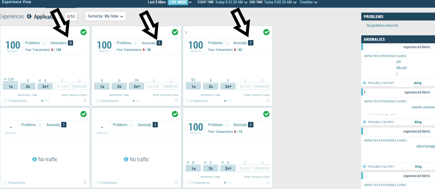

SaaS UI when trying to see Problems and Anomalies:

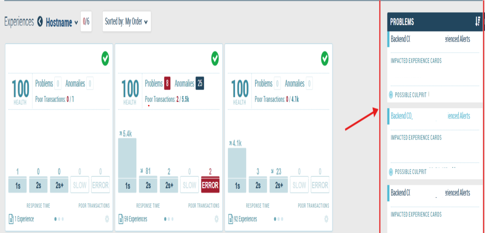

10.8 UI when trying to see Problems and Anomalies:

Problem and anomalies are created based on metric processing (alerts, DA) thus they cannot be recreated with 10.8->SaaS connector, you would need to send all metrics it means you can connect the agents directly to SaaS instead of 10.8.
The expected behaviour is that you do not see problems, alerts, metrics in SaaS when ingesting just topology.
