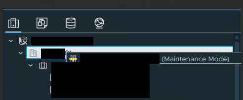

Step 2: Move the ESXi Host out of the cluster within vCenter.
  • Within the vCenter, locate the ESXi host that is in Maintenance mode and drag it out of cluster.
