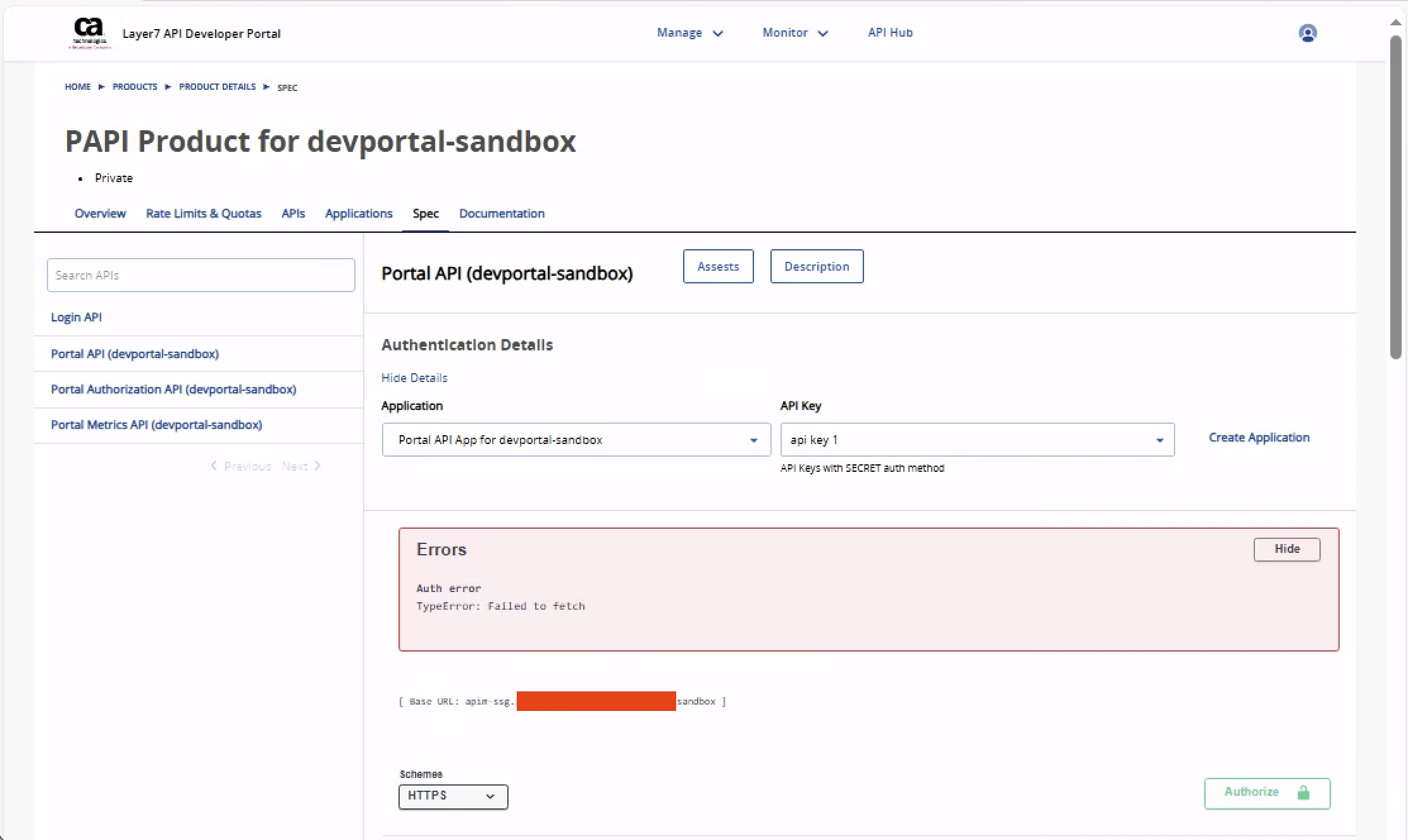

You are currently trying to authorise and retrieve a bearer token to perform CRUD operations through the PAPI Application in the API Portal.
However, the process keeps failing with "Auth error Failed to fech".
Further troubleshooting shows that the issue is with the certificate authority. This can be checked via the Browser Debug Console...
