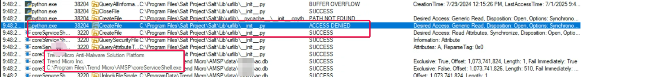

Using procmon to trace the process returns the below:
Based on above, AV solution (Trend Micro in the above case) was blocking the creation of the .py files.
Add 'C:\Program Files\Salt Project\Salt\Lib' to exclusion on the AV solution. .  Salt-minion is built on python and will attempt to create and execute the python files in the directory.
