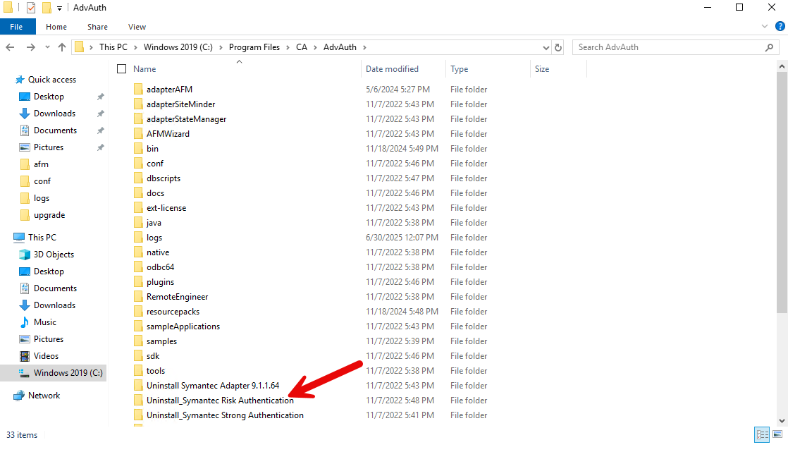

Check the Install Location:
  • Verify at the Install location if Risk binaries are present.

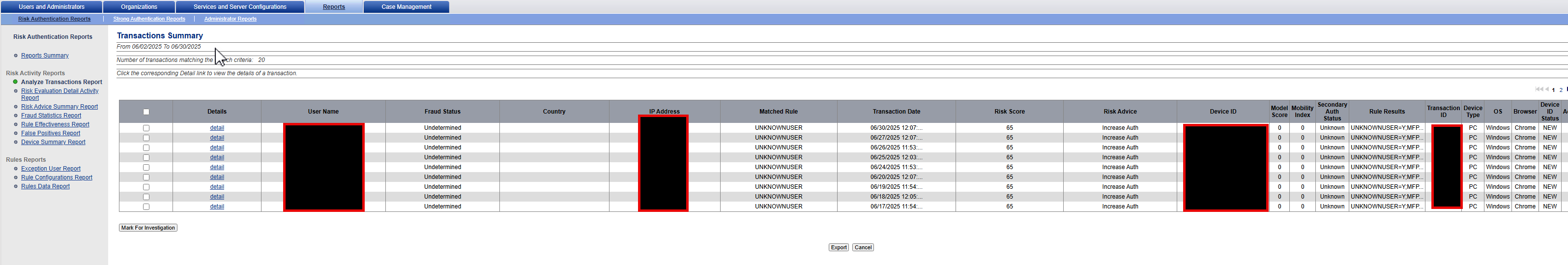

Run the Report from Admin console:
  • Other way to find out Risk solution is utilized by running the report from Admin console, Analyze transactions report is captured for every transaction and if that has data for users, it indicates that the Risk is being utilized.
