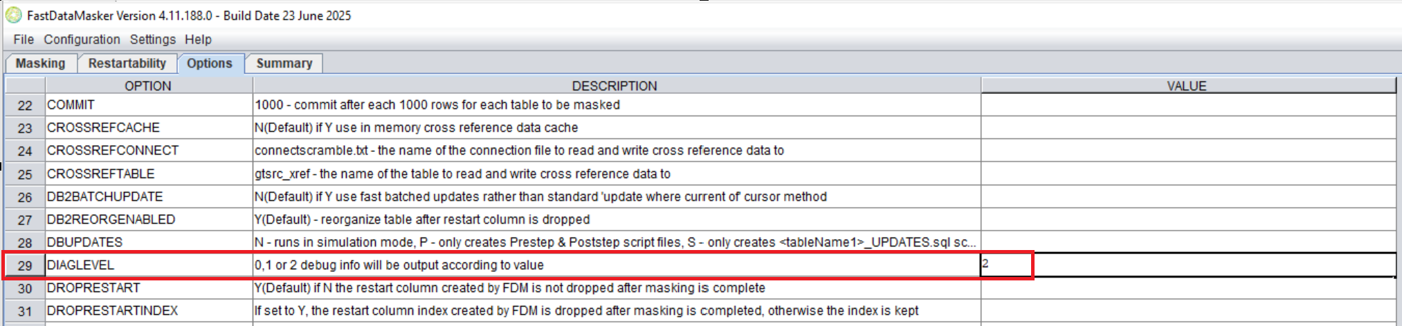

  • The masking option DIAGLEVEL is used to set the level of diagnostics to be logged during a masking job. The possible values are 0 - 5, where 0 disables logging (no diagnostics) and 5 being the deepest level of diagnostics. The default level of diagnostics is 1, where general information is logged, along with any errors recorded.

    4. Select the 'Options' tab, and set DIAGLEVEL between 2 and 5. Where 2 is the lowest level of debugging, and 5 being the deepest level of debugging.
      Note: Debugging will slow down the masking job, so keep this in mind. If the masking job is large and complex, setting the diagnostics level to 5 could slow down the performance of the masking job significantly, due to the level of logging. It's recommended to use the lowest level for debugging whenever possible, for large and complex jobs.
