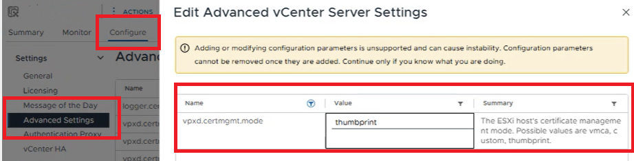

The certificate mode on the vCenter Server is configured as "Thumbprint".
VCenter Server > Configure > Advanced Settings > vpxd.certmgmt.mode is set to Thumbprint

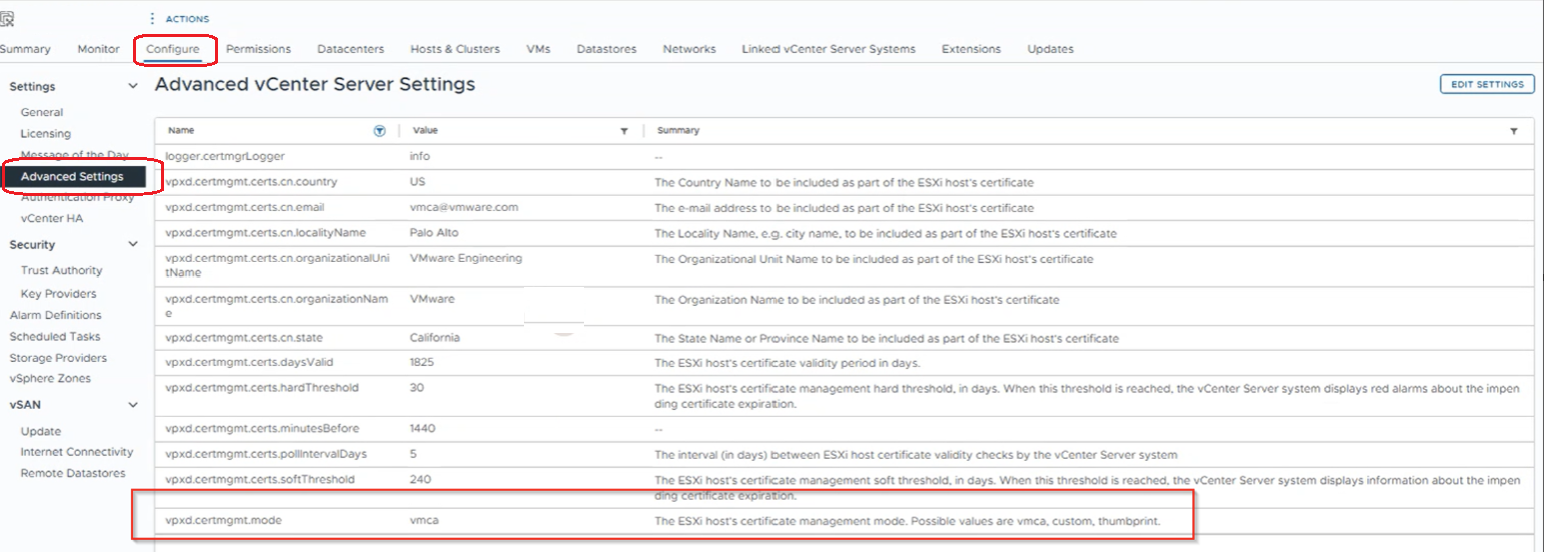

In case the hosts aren't using custom certificates, hosts managed by the vCenter server should have their certificate authority as "VMCA", which means that the vCenter server's certificate mode should be set to "VMCA". Thumbprint mode is not the recommended mode and is only used as a fallback option.
Refer below screenshot which confirms the vCenter's vpxd.certmgmt.mode is set to correct value i.e. vmca
