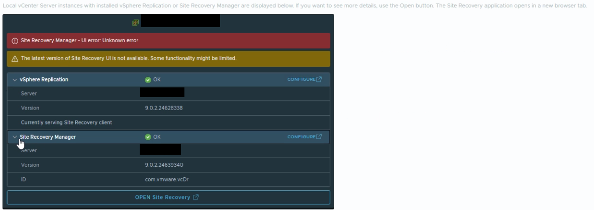

Symptoms:
  • Event message on the Site Recovery UI page on the vCenter: "Site Recovery Manager UI error - Unknown error and The latest version of Site Recovery UI is not available.  Some functionality might be limited":
  • Event messaging started appearing after upgrading the vSphere replication and site recover manager appliance to version 9.0.2.2
  • vSphere replication version 9.0.2.2
  • Site Recovery Manager version 9.0.2.2
