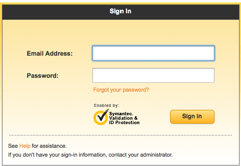

  1. Log into VIP Manager with username & password.
