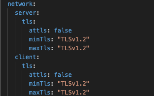

Tried to disable TLS 1.3 by using the following setting in ZOWE.yaml
However, ZOWE stc log shows:
The JSSE TLS 1.3 implementation does not support post handshake authentication (PHA) and is therefore incompatible with optional certificate authentication
Looks like TLS1.3 is still in use somewhere? How to verify TLS1.3 has been disabled on the server side?

Setting in zowe.network section only takes effect on ZSS and Application Server (Zowe Desktop) components in ZOWE v2.18.0, see github issue here.
And other components such as gateway are still using TLS1.3 (by default).
zowe.network section values should take effect on all the ZOWE components, issue is fixed by ZOWE v2.18.1.
Upgrade to ZOWE v3.1.0 (or above) is recommended.
Or at least upgrade to ZOWE v2.18.1.
If zowe.network has been specified to use TLSv1.2, the negotiated protocol should be TLSv1.2 for all the ZOWE components after the ZOWE upgrade.

For example, if TLSv1.2 is specified in network.server section in ZOWE.yaml,  the output of the above openssl s_client command can be used to confirm that TLS1.3 has been disabled.
SSL-Session:
    Protocol  : TLSv1.2
