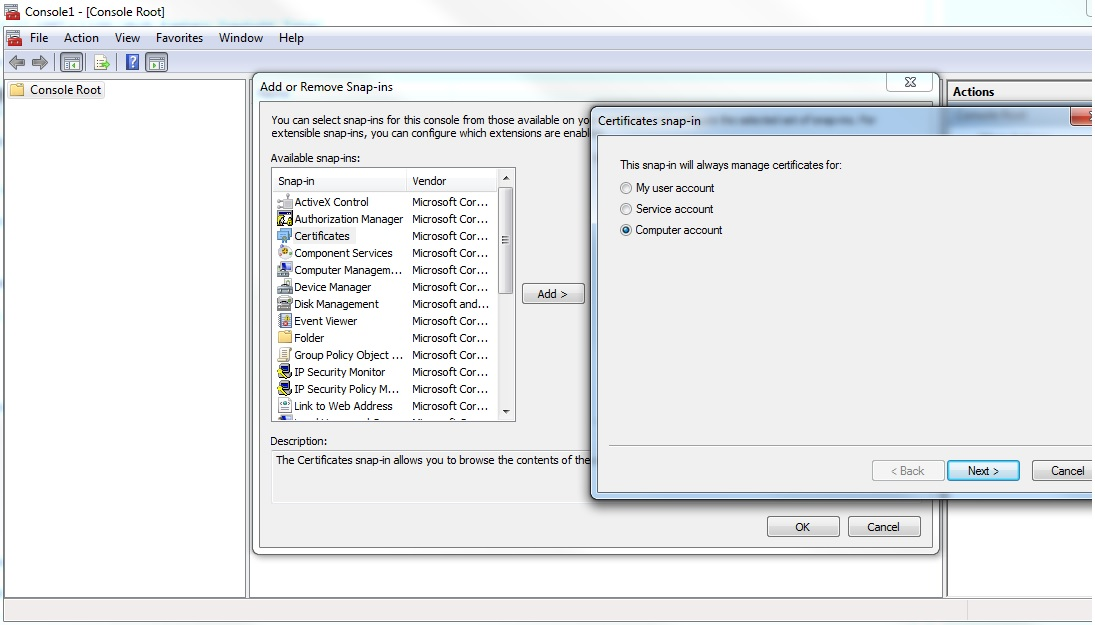

2. The other option is to load the certificate into the Computer Account instead and leave the service to be run by the Local system Account.
i. On the C++ Connector server machine, open up the MMC
Start->Run-> mmc
ii. Go to File->Add/Remove Snap-ins
iii. Select the Certificates snap-in and click Add
You will now get the option of :
My user Account
Service Account
Computer Account
iv. Select Computer account and then proceed to import the certificate in the trusted root store.
v. You need to restart the C++ Connector Service after this.
