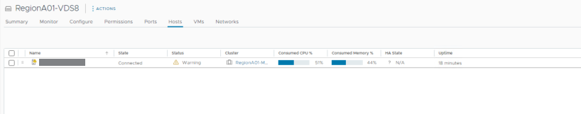

  • Following error, "Removal of Distributed Virtual Switch (DVS) from vCenter server not allowed as there is at least one ESXi host connected to that DVS" is observed while decommissioning the host cluster from SDDC manager as vSphere Distributed Switch (VDS) removal failed.
  • On navigating to the vCenter UI -> Networking -> VDS (which can be referred from the above error screenshot) -> hosts, Mobility Agent Host was noticed.

Mobility agent host was referencing this VDS. This is expected behavior, if cluster decommission is attempted before disabling it from the HCX service mesh.
Please follow the below steps to gracefully remove Mobility agent host.
  • Make sure no current HCX migrations are in place.
  • Disconnect the Mobility Agent host from vCenter UI and then remove from inventory.
  • Resync the Service Mesh (SM). This will get the Mobility Agent back under vCenter inventory. Refer this doc on how to resync the service mesh.
If the above steps, still don't help - user can recover from the error by removing the Mobility agent host from vCenter VDS.
