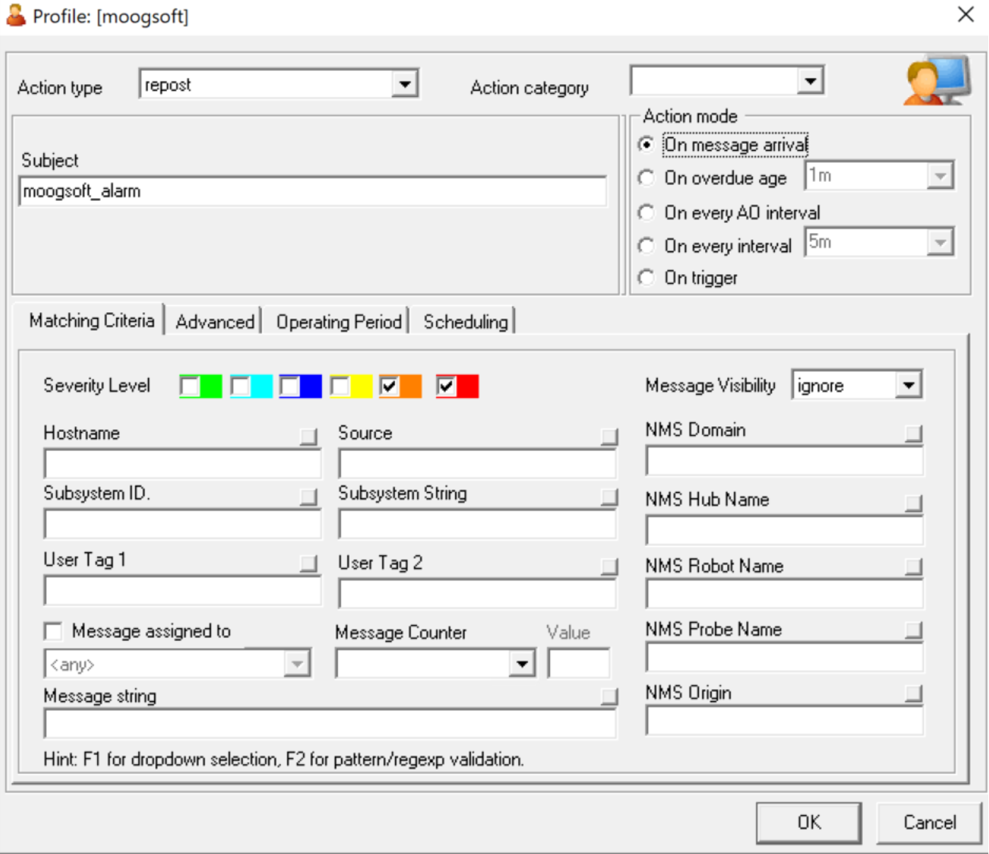

  3. Now, in the NAS probe, you will need to create an Auto-Operator rule of type "repost" to repost the desired alarms to the moogsoft_alarm subject/queue.  The below example shows a simple profile where all Major and Critical alarms are reposted on arrival.
This can be customized in whatever way is necessary to select specific alarms for inclusion.  Only the alarms that match the profile will be reposted to the moogsoft_alarm subject and be forwarded to Moogsoft.
You may also choose to check the box for "Clear" severity so that alarm clear messages would also be sent to Moogsoft.
Keep in mind that this means ALL Clear events will be sent to Moogsoft, even those which correspond with alarms that were not previously sent.
In other words, if you check the boxes for Major, Critical, and Clear, then you will get Clear alarms sent to Moogsoft which correspond with Minor/Warning alarms that were not sent to Moogsoft.
