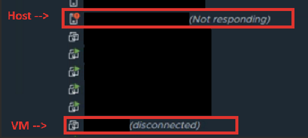

After an ESXi outage results in a host being permanently offline (e.g., due to hardware failure), VMs registered on this host show as disconnected or orphaned in the vSphere Client. In some cases, the "Remove from Inventory" option is unavailable or greyed out.
Symptoms:
  1. Virtual machines status displays as Disconnected or Orphaned.
  2. Attempts to re-register these VMs on a healthy host fail with the error: VM already exists.
  3. The Remove from Inventory task is greyed out for the affected VMs in the vCenter UI.
