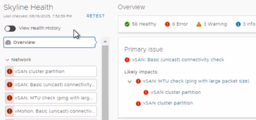

After firewall changes were made multiple vSAN clusters showed many vSAN objects as inaccessible  and VM show as invalid in vCenter or host UI. The vSAN Skyline Health checks shows alerts for vSAN cluster partition and vSAN Basic (unicast) connectivity.

A change on the firewall interrupted LACP traffic so that after a host reboot or other network interruption the network connection to other hosts could not be reestablished. The firewall issue caused a cluster partition between various hosts in three separate vSAN clusters. This lack of communication between hosts led to a situation where many data objects did not have quorum and could not be accessed. Ping testing across the vSAN network confirmed loss of connectivity between hosts.
